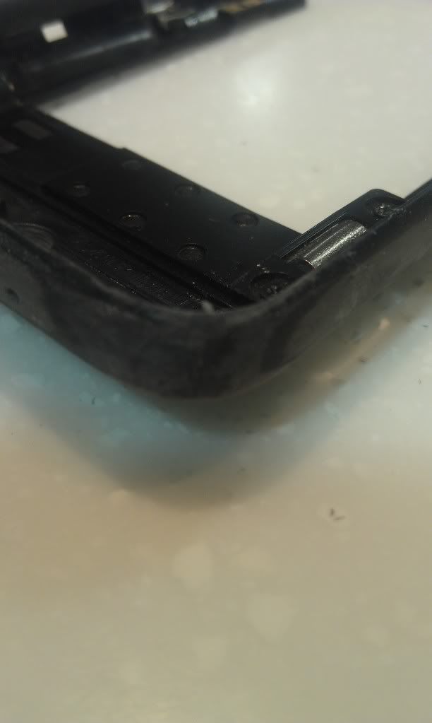

Bought a broken thunderbolt on ebay one night * drunk bidding never turns out good * anyways, the phone arrived and actually turned on even though it was sold as not turning on. So I ordered a lcd and digitizer and while waiting on them to arrive I fixed a crack in the casing with epoxy and bondo, and repainted the case grey. I had the bright idea if painting it white. I'll throw up some pictures soon, the phone isnt all back together yet and I still need to finish polishing the kick stand, but I'll post progress pictures once they are done uploading..
---------- Post added at 06:31 PM ---------- Previous post was at 06:25 PM ----------
Heres the crack after sanding down the case
and then the epoxy
lil bondo
and the grey paint
and now white
Also the extended battery back was all scratched up so I roughed it up filled it and sprayed it the grey color, I thought it would be too much white.

I can type something up, I have a very small amount of body work experience, took it in hs. If I had to do over again I would have used different paint. I used kraylon fusion, which is very flexible and for plastic. I thing regular automotive spraypaint would have been better, something I could have used a clear coat on.

I used a CA glue of medium consistency, a bondo brand one part spot putty, and I would suggest regular automotive spray paint. All in all youre looking at around thirty in repairs, and after a day of use i can see a hair line crack where the crack was.
